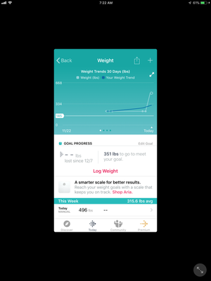

I have a Versa 2 for about two weeks.  I log my weight in as 225. Pounds. The app registers it as 496 pounds. I went from having to lose 81 pounds to 351 in one day. Also the water logs in incorrectly. Ounces logging into the Fitbit get converted to millimeters. I am using an iPad. I am manually changing each weight and water entry in the app,  which makes the Fitbit useless to tracking water and weight. I tried to: reset the Fitbit twice, Hold the left button for 10 seconds, reinstall the app twice and upgrade to IOS 12.4.4..with luck.
