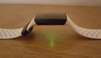

I have noticed this depending on how my trackers were sitting.  For example, my Charge 3 when sitting as shown below continued to try and track my HR as you can see from the green light reflecting off the table:

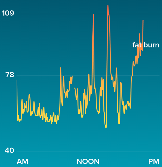

I think there is some kind of proximity sensor that activates the HR sensor. This does not happen when I lay the tracker on its side. As to HR, the last half hour of the HR chart shown below is with the tracker on the table and it shows an increasing HR into the fat burn zone.
