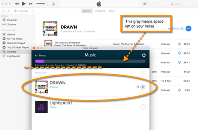

MACBOOK
important note: if you have TONS of playlists/ GBs worth of music in your iTunes, this can be a little annoying since it takes the fitbit connect app quite a while to read through all the files. I personally do not use itunes on my mac so this was super easy for me.

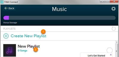

If you haven't already, download the fitbit connect Mac app and log into it.

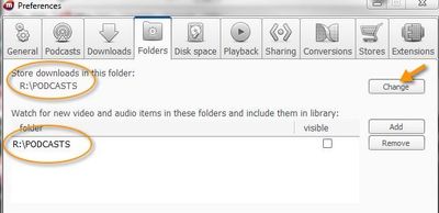

If you do not have iTunes or prefer not to use it for downloading podcasts you can try Miro or any other podcast downloading tool of your choice.
Miro instructions (note I've experienced slight garbling and weird little noises when using this method. Can be a little jarring):

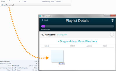

Click back when done dragging and dropping

Thank you so much for this. I've been struggling to transfer playlists all day. I was stuck at the point where I had the playlists open in the Connect app. Fitbit CS had no idea how this worked. I didn't realize you had to click on circle to the right of the playlist-- that "x" makes it look like it's for deleting! Also they don't bother to tell you that part in any of the docs.
