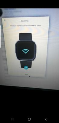

Well, on the video, the watch was connected to my pc. Not the laptop, where I was trying to connect the wifi. But even after I connected the watch to my laptop, it did the same thing - it says not connected at the end.

Sorry but through my phone, I was unable to see much on the video. Your bouncing between 2 screens on unknown devices.
I did see this screen, at 0:47 that shows that the versa was successful in connecting to WiFi, and this was followed by setting up. I'm not sure why after successfully setting up the WiFi the video goes back to setting up WiFi.

On the screenshot, it says, that the connecting succeeded.
But if I look at the connection (the last part of the video), it says not connected.
According to this post, it should show my network IP.
Also, internet dependent apps do not work, such as weather or Workout Genius. So I believe, that the watch truly isn't connected to my wifi. Is there anything I am missing?
