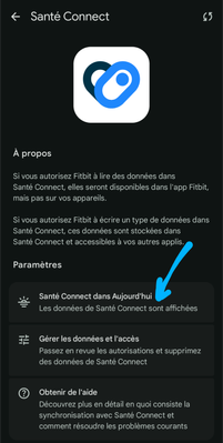

When I switch back to the normal Fitbit app all the workouts and data do synchronise but when I switch back to preview it disappears.

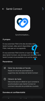

While looking into the issue I noticed that on the preview app you you can't choose to show data of health connect on Fitbit on the configuration menu

First picture is normal mode, second preview mode
