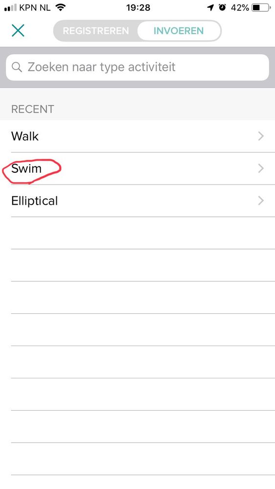

@JulieVionic I registered a swim workout/activity by means of the app.
 You only have to enter start time and duration in following screen to log your swim. Good luck!

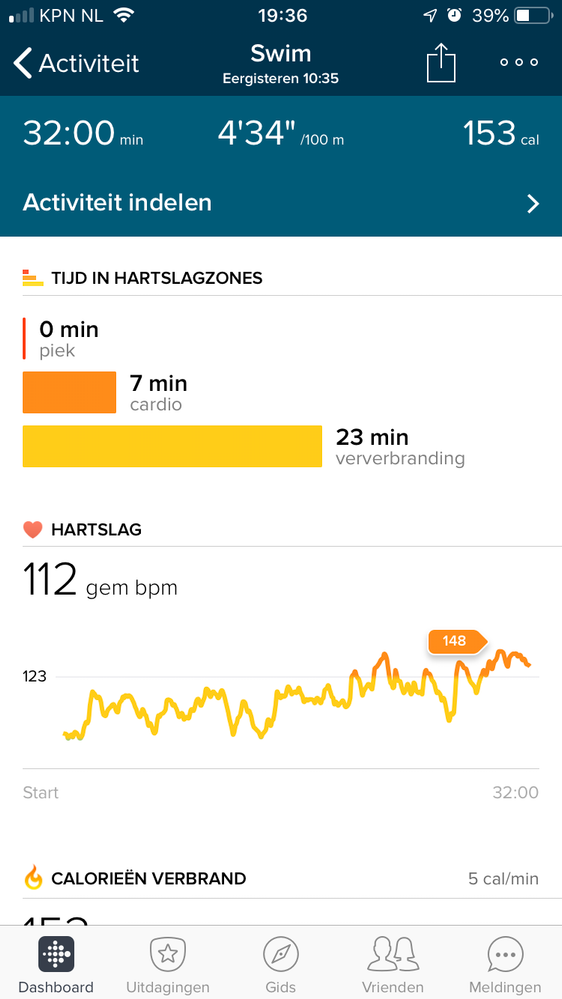

@JulieVionic This is the result:4C33AC63-B773-4300-99AA-3353439AF8CA.png
