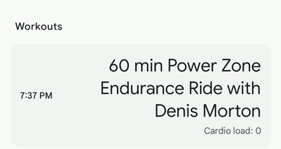

60 minutes of peloton zone 2 and zone 3... Cardio load. 0.
ZERO.
55 Zone minutes. 30 in vigorous, 25 in moderate.
