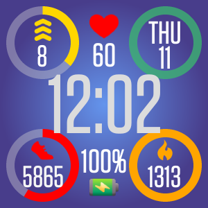

Wondered if someone had already done this and therefore if it's doable as I can't find any references in the developers community posts.
Basically, I've created a watch face that I like BUT as I'm getting on a bit my eyes aren't what they used to be and I would like to create a function that would display a larger font when a specific area is pressed. (and yes I could just enlarge the font but a) I'm trying to make a face for the many not just old people like me and b) that would be way too easy and still in lockdown challenge mode!)
My watch face is this (currently waiting approval)
So I would like to press the 'steps' arc (using maybe a hidden button) and this brings up the arc/current steps to fill the screen at device width for 2 seconds then it goes back to normal. (or any size bigger than current; my idea was full screen so I wouldn't need to faff around too much with overlays etc. So it would look like this after pressing it.
Would this be possible?
