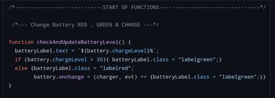

This is a great resource for beginners if you haven't used it yet: Fitbit Github . You might have fun contributing to that github once you make a clock or app.
Here's the battery function I use. My battery is just text, so I'm using the javascript function to change the text.class in my .css file to green font or red font. The key is to call the function from INSIDE 🙌 the clock.ontick event so that it updates every second. All functions should be called inside the .ontick event. You must also set the clock.granularity to seconds or it will default call your functions every minute (which is kind of slow)
Hope that helps.
