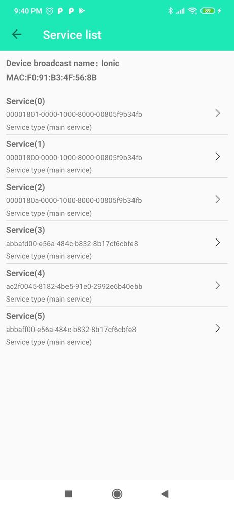

- Permalink
- Report this post
- Who Voted for this post?
Already connected like this using BLE from android studio, but still have no idea about how to get the heart rate.
