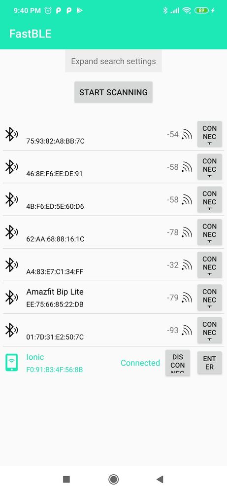

Already connected like this using BLE from android studio, but still have no idea about how to get the heart rate.
