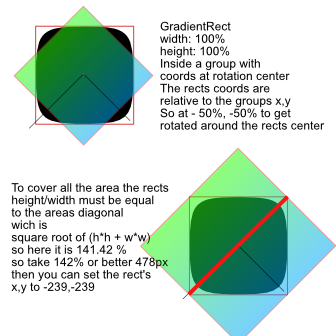

I have a gradientRect as the back of my clockface svg. I want it to be rotated 45 degrees diagonally so the gradient goes from the top left to the bottom right not side to side. I've tried wrapping it in a g container
<g transform="rotate(45)">
<gradientRect id="bg" width="100%" height="100%" />
</g>
#bg {
gradient-type: "linear";
gradient-x1: "0";
gradient-y1: "50";
gradient-x2: "0";
gradient-y2: "100%-50";
gradient-color1: "magenta";
gradient-color2: "red";
It rotates the gradientrect but moves it out of place. I also need it to cover the whole screen. Any idea the best approach to have a diagonal linear gradient? Thanks!

Hi, I think you might need to add a translate to the group, as its coordinates are the center of its rotation , then set your gradientRect's (x,y) to its (-width/2, -height/2) to place it centered.
To enlarge the rect to cover the whole screen you could calc the needed size using good old pythagoras.

To get length of the diagonal, which would be width and height needed for a 45° rotated rect it's:
needed size = squareRoot(screenWidth * screenWidth + screenHeight * screenHeight)
Set outer g to (centerX,centerY)
the rect inside the g to (-neededSize/2, -neededSize/2)
