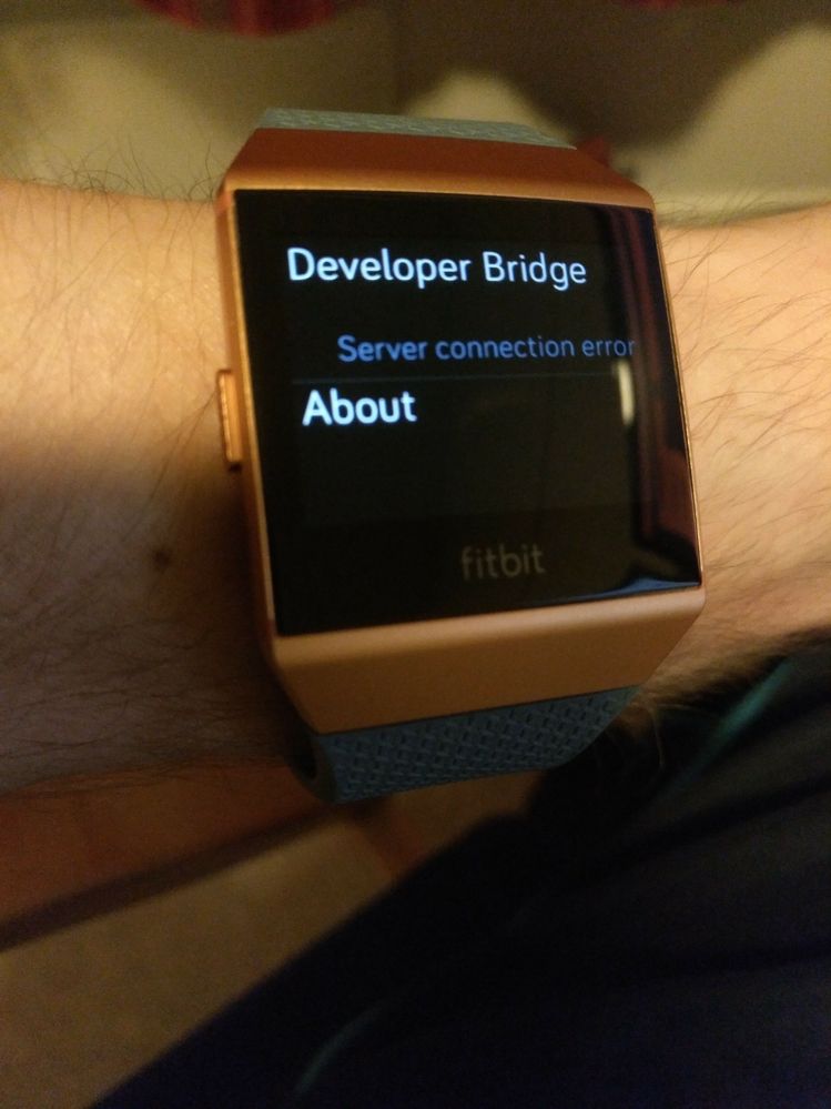

Hi! I tried to install the beta firmware but it failed because there was only about 30% of battery left. Now, I have fully recharged the battery but I cannot ignite the beta firmware download again. What to do?
PS. I have the firmware version of 27.30.3.2. I guess this is not the beta?
Thanks for all the help!

I usually have to try twice before it connects.
Once connected (message on the watch), you will still have to connect on the studio.
Also, are you on 5ghz wifi? I read on the other forum people have issue connecting on wifi.
It could be that.
It could be that.

I was able to connect the Ionic to Studio. I was able to install a test program and run it! Thanks!
PS. No, I think I only have ~2 GHz Wi-Fis around.
