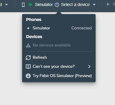

Installed the simulator yesterday and it worked great. But today I get "Simulator failed to start: connect ECONREFUSED 127.0.0.1:63981 The studio sees the simulator and says its connected thou, but list new available devices.
