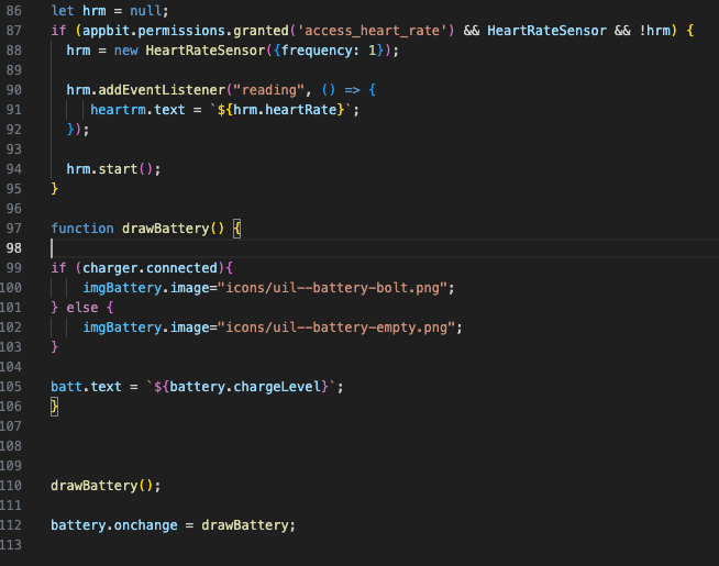

Hi i have done a clockface for my sense 2, in the simulator with sdk 6.2.0 all works fine, but when i convert to sdk 7.2.0 and install via private link the battery level text and heartrate are not displayed.
The code is :

Hi @Takeshi81 - I agree with @Gondwana - stick with 6.2
The error may be because you didn't give it a text-length in the SVG - it receives a 0 length if not initialised or one isn't specified.

I'm not sure 7.2 will give you anything more than 6.2 does, so I'd stick with 6.2. This might be relevant.
For a giggle, you could try initialising element text to something in the SVG and see if that appears.

Thanks for the hints, i'm using sdk 7.2.0 because i need to build for hera,rhea since i have a sense 2.
Indeed the problem was the text not being initialised.
Now everything working 🙂
