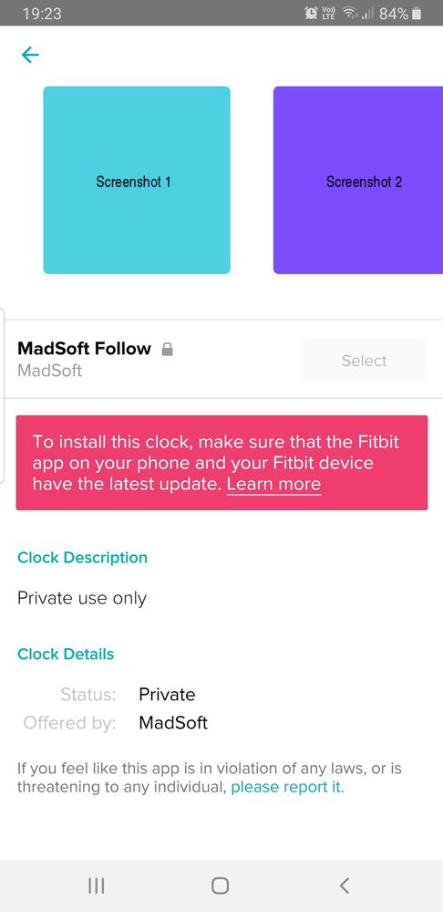

Bought a versa lite, created a small app in fitbit studio and wanted to install it. It works only in simulator without any problems. Unfortunately, in the fitbit app I am not able to install/select the app. It shows error saying I should have the latest update. Bought a versa lite yesterday, installed fitbit app yesterday still I need to update? I do not understand why the confusing error message is shown. Here is the message:
To install this clock, make sure that the Fibit app on your phone and your Fitbit device have the latest update. Learn more.
In the documentation it says if an update is available it would be visible in the Fitbit app else not, so I assume I have the latest version of the app.
Thanks for helping.

Best AnswerYour watch firmware is out of date. It won't be able to run anything developed on a more recent SDK than 3.0.
The Fitbit app on your phone should be letting you know that there's a firmware update available.
Best AnswerThanks for the info. The Fitbit app did not suggest any updates. I manually went to Help>Device>Check for Versa Lite update, it says Versa Lite is up to date!.
