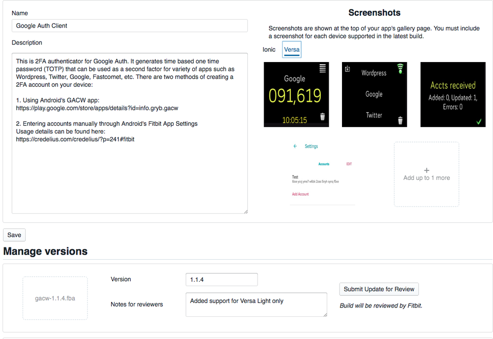

The release process is very slow. It took 10 days for the last review, and the app was still rejected, because screenshots for Versa Lite were not provided.
Where should I put screenshots for Versa Lite? There are only two tabs: Ionic and Versa (see the pic below).

At that point, it's not actually uploaded the build. You'll need to submit, then add the screenshots.

The Versa Lite tab appears when you add a build with support for Versa Lite.

The Versa Lite tab appears after you upload the build, then you add the screenshots. It's not really obvious unfortunately.
