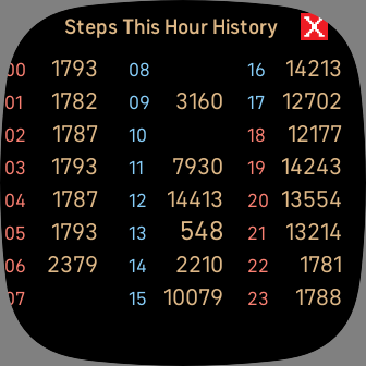

Hi @JBDow - you can check on the hour how many steps were done, but if you are going to do reminders it gets more complicated.
Have a look at SimpleClockPro which shows steps done [or left to do] so far this hour, along with reminders to move at 40, 50 & 55' minutes and Steps This Hour history. It's quite a challenge!
SimpleClockPro steps per hour
