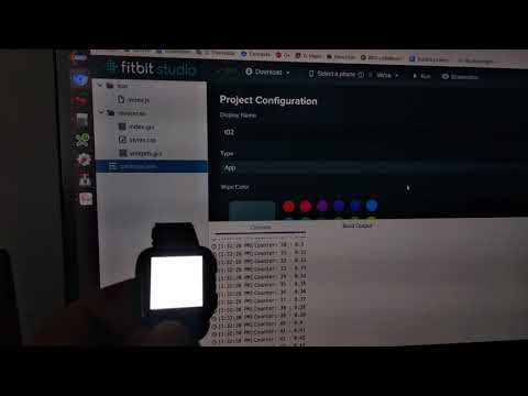

Still not working. This time I put the code on github (https://github.com/casainho/Fitbit_Versa_testing), it is the same code you suggested but I added:
console.log("Counter: " + counter + " : " + display.brightnessOverride);
I recorded a video showing the app running (phone camera was with light level blocked) as as you can see, it does not work 😞 😞
https://www.youtube.com/watch?v=GkQE4MZWR3A
After upgrade to new firmware on Versa (Fitbit OS 3.0) and select SDK 3.0 on Fitbit Studio, now it works!! I was expecting a lower brightness on the min value but seems to me that min value is equal to the value of "dim" brightness on the configurations of brightness on the Versa configurations.
