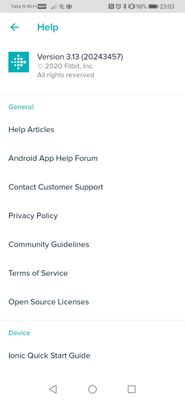

Which version of Android are you using?
Best Answer01-23-2020 13:48
01-23-2020 13:48
Best Answer01-23-2020 13:51
Fitbit Developers oversee the SDK and API forums. We're here to answer questions about Fitbit developer tools, assist with projects, and make sure your voice is heard by the development team.
01-23-2020 13:51
And you're definitely using the 3.13 Fitbit app?

Yes positive :
Same thing with kws, no sign of any request being received. Do you have any tips on how to debug this programmatically? Where is the error message "Failed to fetch" thrown from? Sounds pretty generic
