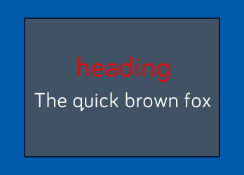

Thanks for the suggestion. I tried all of those events on both the mixed-text and copy/text elements, but nothing triggered a re-layout.
Here's an example of what happens if the copy/text is changed from a one-liner to a longer string (the full sentence):

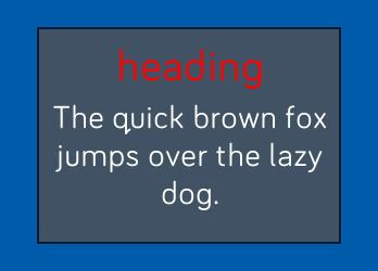

Here's what it should look like (and DOES look like if the .gui string is three lines long):
I feel that setting the copy/text.text in javascript should automatically trigger a re-layout.
