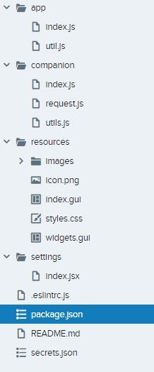

Are you using Fitbit studio? If so, and you click on App in the tree on the left, do you see a file named index.ts or index.js? under app? I believe that the message is saying that you don't, but you need one or the other.
If this doesn't help, can you expand all nodes in the tree and post a screen grab?

I am yes, and yes I do. That is what the message seems to be saying, but I do see a file here with that. Here is an image of a program I loaded that I got from the Ossapps github (so I know it SHOULD be working).

I downloaded the code and copied it into a blank project. I also created the secrets.json file as described in the README file (I used the exact code in the README so I don't expect the app to actually work). I also omitted some files that I believe were created by Fitbit studio.
I am able to build and run the app, although it fails.
