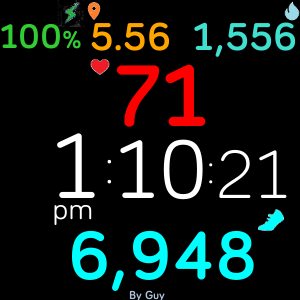

On my old Blaze Fitbit watch, I could swipe to the heart rate display and it would stay there until I clicked a button to revert to the clock. But when I open the Sense 2 heart rate display, it keeps reverting to the clock display after a few seconds. The heart rate is shown on the clock face, but it's too small for me to read unless I squint or wear my reading glasses while I'm exercising. I like the Sense 2, which I recently got as a gift, but I wish there was a way to keep the heart rate display until I'm done with it, like with the Blaze.

Hi @LF5 - try changing the clock face to another with a larger heart rate display, such as SimpleSports made for seeing the most salient information at a quick glance, either on your arm or rotated on your wrist when worn normally.

I don't think @Guy_ 's clock face will help. I put it on my Sense 2. It is in a rotated position and there are no settings in the clock face details to change it. It's AOD display is a generic clock face.
