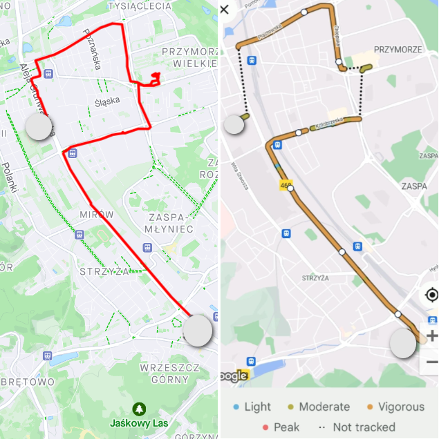

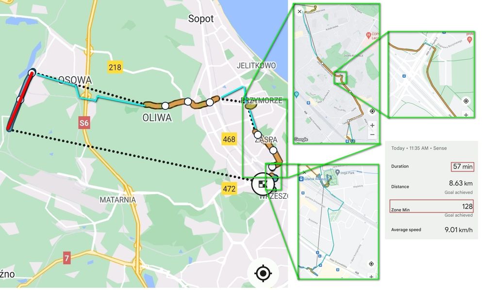

Today I had a 18 km ride with both Sense and Strava tracking on.
Strava reports 18.3 km, FitBit 8.6 km. Map on FitBit exposes rather weird Sense's behaviour.
Did anyone experience anything similar?
What can be done to make Sense's behaviour consistent?
Attaching the real route from Strava and map views from FitBit.
Strava:
Fitbit:
Thin cyan lines denote actual (approximately) route, added by hand.

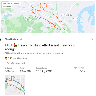

P.S. The screenshot below shows the today's route captured by both Strava and Fitbit. Strava reports 10.48 km 41"33' while FitBit reports 5.36 km 24'30" (no idea why it shows as 5.34 km when synced up to Strava).
