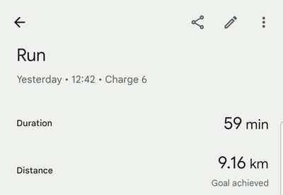

So 9.16km or 9.25km?
The Fitbit app says 9.16km:
...but is it...?

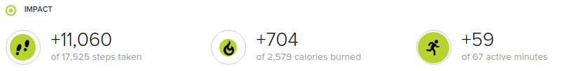

The activity summary in the web dashboard says 11154:
However, after opening the activity the impact says 11060 steps:
This means, there are also two different records of steps taken during activity 11154 and 11060, a difference of 94 steps. That probably could explain why we have also a difference in distance of 90m (by stride length that difference for me is 104m since the distance isn't measured exactly by stride x steps but is a little more complicated and is quite close to 90m difference). So now we have different 3 different distances, two different step counts and I didn't get yet to the GPS data.

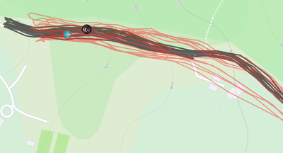

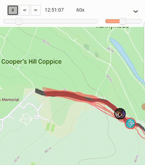

Looking at the Strava Flyby feature, red is Fitbit, and grey is an accurate GPS tracker. The map shows intervals and on top of the hill. Fitbit doesn't seem to get there and always lags slightly behind a different GPS tracker. This tells me, there is a delay in reading the GPS data and/or some data smoothing. When I got to the top of the hill I turned around and that little segment was never captured (there were 8 reps).
The actual distance was 11.04km (by GPS) and 11.03km by foot pod.
Here's what it looks like in motion (it shows single runner wearing two watches during the same run):
Fitbit GPS lags behind and cuts u-turn.Fitbit GPS lags behind and cuts u-turn.
So Strava distance is probably the least of your issues when using Fitbit for running 🤷

@Triletics, I have noticed that a long while ago.  I use to track my rides with Strava, fitbit and bike computer.  When I ride back and forth on a linear path, the fitbit always looks like I turned around slightly earlier.  Doing the flyby and comparing all 3 rides, the fitbit was always seems to be a couple of seconds ahead of Strava.  It seems like fitbit doesn't syncing its clock down to the exact second, thus when recording a session, it arrives at same location while its internal clock is slightly behind, hence, on playback, the fitbit is ahead.
