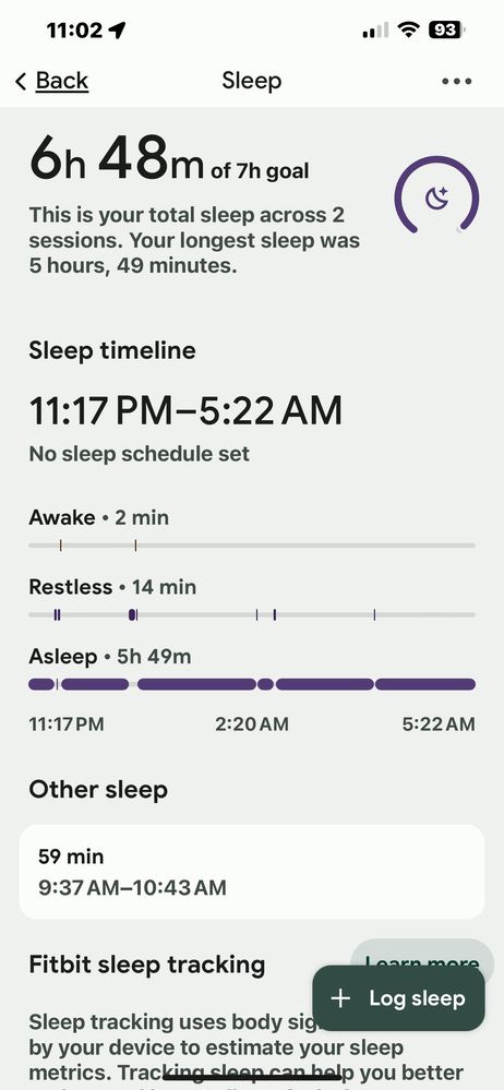

My Sense 2 is fully updated, I’ve tried normal & sensitive settings, I’ve tried left and right arm, I’ve read the forums and tried all the recommendations but I am only getting simplified sleep instead of Sleep Stages

Hi, No I am not a Premium member? I only get non-simplified sleep stats if I pay? That doesn't sound right. I have several friends with the Versa, that are not Premium and they get sleep stats.

Appreciated. None of those conditions apply. In fact, I called the Fitbit help desk and was connected to an advanced tech that could not help (Case: ****). My girlfriend also has this problem but it's intermittent (randomly). I had a Versa that worked prefect, only after buying the Sense that this problem began.
I reached out to the forum with hopes that someone else has this problem: I have an iPhone, maybe it's a setting in the watch or the phone, maybe its an app (or face) on the watch causing the problem (which is what Fitbit tech thinks), lots of maybes 😞

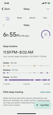

The problem isn’t that data not recorded it’s that the detailed graph is missing
