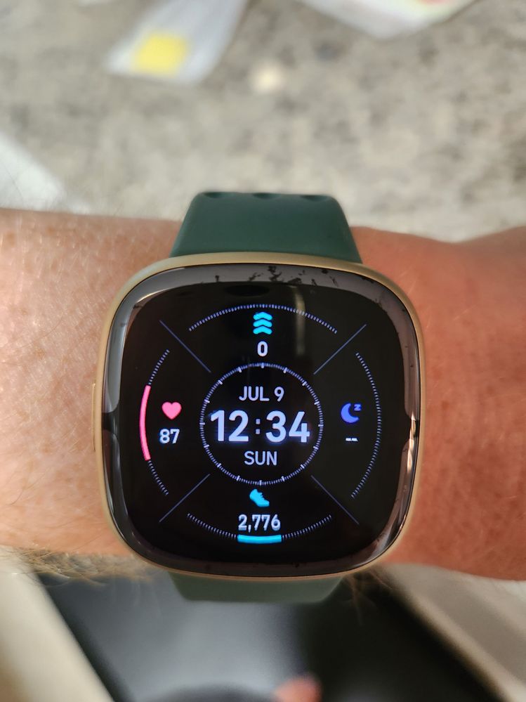

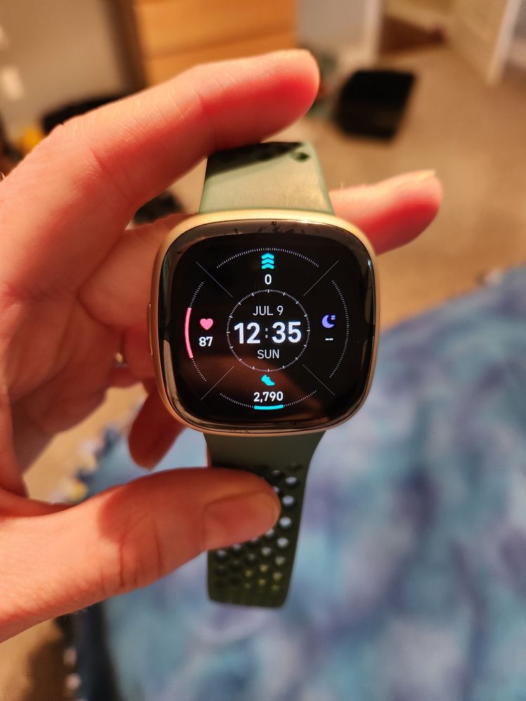

I am having the same problems. My heart rate has stopped tracking and the green light on the back of my watch just stops randomly also, for hours at a time. In the heart rate tile on the watch it'll show my heart rate (which isn't accurate) and 0 graph and say please wear your watch for 30 minutes, but I've been wearing it all day. Or the graph will only show for a bit and then the tracking stops, even though I've been wearing it all day. I've been wearing my watch all day and the graph doesn't show the last hour. Note my heart rate says 58
The picture is immediately after the first picture and the front face says my heart rate is 87
When I took my watch off it is still saying my heart rate is 87 and the green light isn't working.

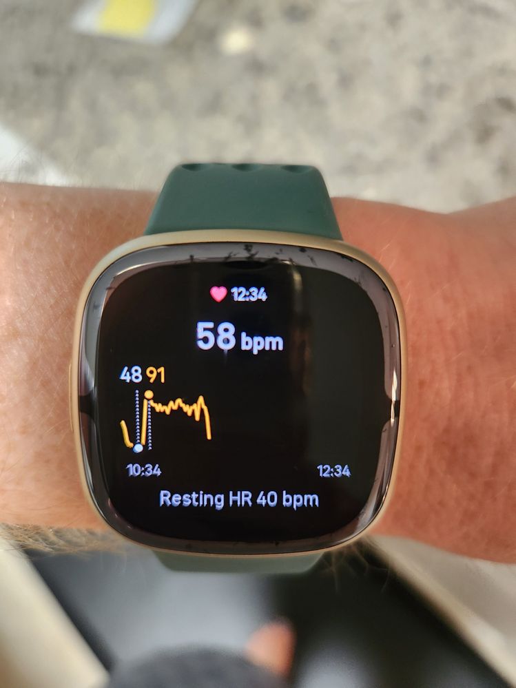

I'm still having issues. It's not tracking my heart rate and the lights on the back of the watch either work or they don't work, sporadically and for no reason. I'm so frustrated and do not want to have to do a factory reset on this watch AGAIN! I've had to do that 3 times already to try and fix issues in the past.
I've been wearing my watch all day, and the tracking just stopped randomly, no reason. Note the heart rate says 58 on this tile. The front of the watch says 87
The front of the watch says my heart rate is 87, this was 2 seconds after the first photo.
I took my watch off and it still says my heart rate is 87. No lights on the back of the watch are working.

@DaSchmidt Thanks for the pictures, and because your post didn't mention it, I'd recommend performing a regular restart on your Sense 2 to refresh its performance. Then, wear your watch about 2-3 finger widths above your wrist bone and monitor its behavior.
