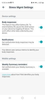

Hello - I just bought a Sense 2 for focusing on improving my Sleep and Stress reduction habits. I sync with a Samsung Galaxy S20.
Unfortunately, I'm seeing buggy behavior with the Stress functions/features after a few days which I don't see with the other functions. It's getting frustrating... and ironically, not helping my stress levels! I list them below.
Any help, insight or confirmation of this is really appreciated, thanks!

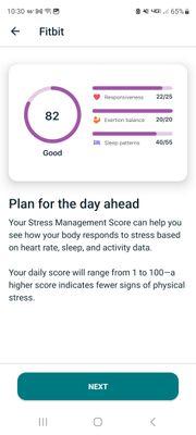

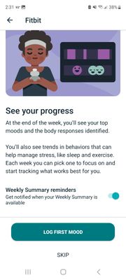

- tapping the stress box/widget on the home screen continually sends me to the first intake & settings dialog, asking me to "log my first mood" and establish my stress settings time after time. Seems like the app software doesn't remember the first time settings??

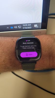

- the Body Responses tab/screen on the Sense2 always shows this below, redirecting to the app. Is that expected? I would've thought either my stress management score or body responses over time would be displayed, similar to the activity summary or heartbeat tab/screens

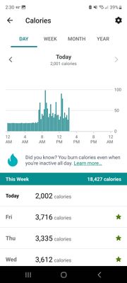

- tapping the Open button on this page doesn't reliably take me to the stress management page on the app. It's brought up the Calories page like shown below or the first Intake dialog described in my first bullet above

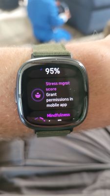

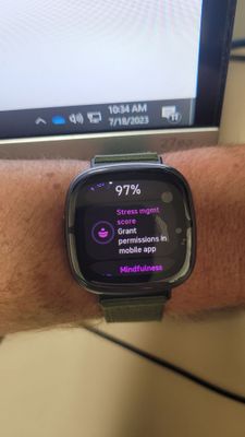

- the "Stress mgmt score" in the Sense 2 data summary list shown below never gets updated and always says to Grant Permissions in Mobile app. Even after I've set all 3 available selections to be ON in the stress mgmt settings of the app. Is there another setting I need to enable somewhere? Can't find if so.

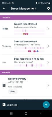

To set up Stress Management, you will have to set up the cEDA sensor. To do that log your mood from that second picture you posted. After that, you will see a settings icon at the top right corner. Click that and enable the cEDA and the "Get Notified" feature right underneath.

Thanks FSuggest. Notifications work for me, no issue there - I do recieve pings on my Sense 2 when body responses are detected.
Problems I see are as outlined above and I'll reiterate: even though I have body responses, notifications and weekly summary reminders set in the app, my Sense 2 screen doesn't show anything useful (Stress Mgmt Score or body responses at a glance) as other functions. Is there another setting somewhere I'm missing?
Photos below are taken today after re-confirming the behavior

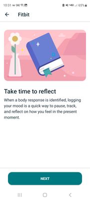

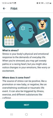

Thanks, Ramoselisa - I think you're referring to the Stress Management "Intake Screens" (I'm calling them) like shown below?
These sequence of questions always show up for me - seems like a bug. No other functions in the app are doing this for me.
Reconfirmed behavior still present this morning.
FYI for anyone else reading this, I have been logging my moods with body responses consistently the past few days and these "intake screens" are still showing.

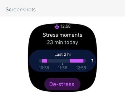

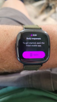

I am having this SAME EXACT ISSUE!! It's making me very frustrated. I have been chatting and talking with support and it gets no where... They are not understanding that the image for what stress tile is supposed to show (as illustrated on the app install screen under screen image) is not coming up ever. I tried uninstalling them reinstalling, the watch, the app, the tile, the watch again... Nothing.
Have you been able to find a solution? Do you know of others that have had this similar issue? Was considering it was just a faulty watch and considering returning it and seeing if a new watch would do the same thing? Were you considering this? It seems to be primarily a watch issue in the first place.

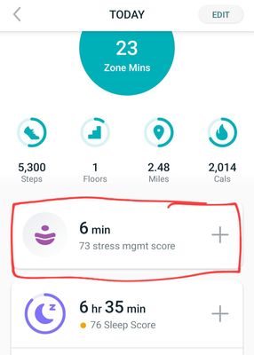

07-20-2023 14:08
07-20-2023 14:08
Ahhh, Thanks Ehughs! I think you're referring to this tile view in the app? EXACTLY - I've never seen this on my watch face.
I havent reached out to tech support yet, trying forums here first. Ive yet to hear a helpful comment or suggestion, just confirmations. I haven't considered changing my watch yet - from what I see, it feels like a software or firmware issue or bug?
