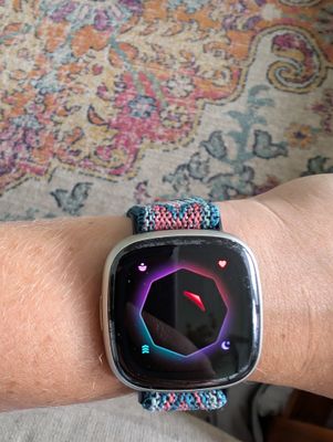

My sense 2 fields are blank, but only my numbers line my clock face and my numbers on my exercise screen and main numbers didn't work. The fields are all empty but you can see logos, like email, text, weather and notifications. But you can't see the notification. I have more pictures to send but can only upload one?

Thanks for the detailed information, and the picture provided. I'm sorry you're having this issue and to look into this, do you know when this started? Have you also updated the new firmware available for your Sense 2?
To work on this together, let me recommend the following steps:

Yes, I've updated the firmware, it's synced, and I have restarted the device many times. Restarting the watch does turn the fields back on for a period of time but it does not fix the problem. The watch still goes blank and the fields are empty at random. And sometimes restarting it works, bit I have to try multiple times.

Thanks for taking the time to try the steps suggested above. Because this isn't the behavior that we expect from the Sense 2, I'd like to connect you with our Support team. To do so, I'll need you to fill out this form so we can look into this further.
This form is only meant for you to use, so let me know once you’re done.
