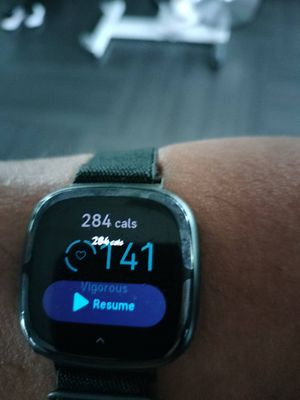

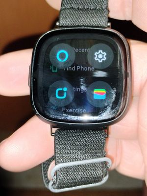

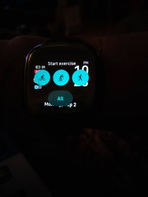

After getting the firmware upgraded to 210.16, I sometime noticed that when I swipe to another app, the privous app is still displayed on screen, along with the app I swiped to.  Then I won't know which app I am actually in.  More swiping, more confusion.  Any shortcut to get out of this?  Sometimes I have to restart the fitbit in order to have a sane screen again.  Here are some sample pictures:

Thank you for letting me know about this situation with the display of your Sense 2 when scrolling. I appreciate you sending the pictures on how it looks.
