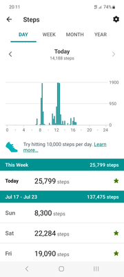

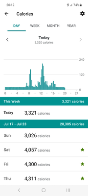

Today, for the 2nd time in as many weeks, my husbands sense 2 has stopped charting steps, and calories only showing his BMR calories as it would when he sleeps.
Heart-rate was fine.
Last week when it happened first time, he reset the device back to factory, after all restarts and cache clears failed.
This week he uninstalled the app and cleared it's cache etc
Now reinstalled, issue persisted so he factory reset the watch again.

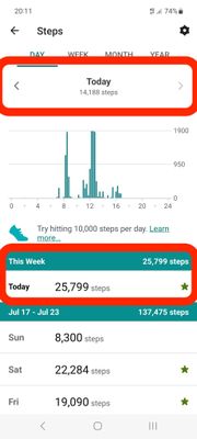

See the steps at the graph total vs the steps for the day which the watch did report on it's own screen prior to the factory reset.  Now that data is lost.
While out on our 17.45 to 19.25 walk his watch vibrated to say he'd met his 3500 calorie goal.  Yet when he got home and sync'd with his phone (he leaves it at home while we walk), suddenly the number in the app was left and the watch sync'd to match the app.

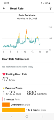

Some of the stuff I've read hinted at heart rate not tracking correctly, yet the heart rate data graph looks fine on both the watch and app.

But it had fully sync'd.   The 25799 was correct.  That had even updated in an app our company are using called Movespring.  Which can read fitbit data to track steps
