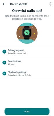

Something seems to have changed after I received my update to oneUI 5.1 yesterday
Before the update, it was strange whenever I was on to the Fitbit app , clicked on (on-wrist calls) both top selections used to have ticks on and the BLUETOOTH PAIRING was never ticked which the button at the bottom used to say FIX ISSUE (i think) but as of now, tonight I tested it, it shows as all fully ticked (just wanted to make sure it wasn't a fluke, I closed the Fitbit app in the background swiping up the app to clear it from background, loaded Fitbit app again and it's showing all 3 ticks)
So I reckon it may work now? I have not yet had any calls recieved (just typical) but on that note I've had an email back from Fitbit tonight stating they may have known about this issue, I can screenshot it in my next reply message if you want to have a read?

@DMI-31 Thanks for taking the time to troubleshoot your Sense 2, and sharing screenshots of the Fitbit app. I'm glad this got sorted out and so we can help other members visiting the forums, I'm going to mark your post as the Best Answer. If you want to learn more about this feature, you can always review this help article.
