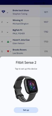

it comes up with this so it Must be on but then the screen isn't on for me to type in the code on the app,

Hi @Benianb - customer support should help but press and hold the watch button for 10 seconds till the display comes on and then blanks or it vibrates, release and wait for the logo to appear and it to start.
If this doesn't happen it may be faulty and best to get a refund rather than a replacement if customer support can't fix it. You then have the option how to proceed.
Fitbit have a 45 day refund policy or possibly authorised dealers too, some stores provide 14 to 30 day refunds.
