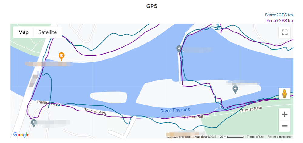

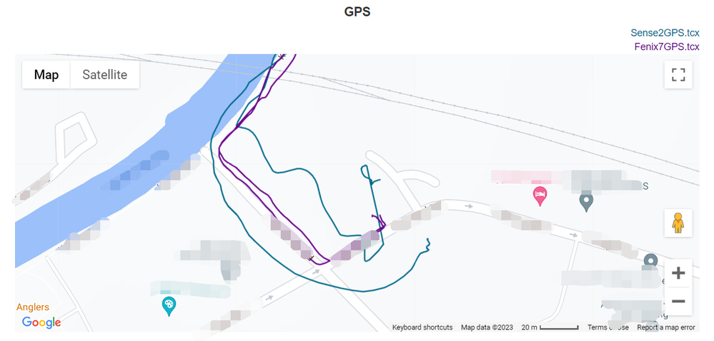

Unfortunately the GPS performance on the Sense 2 is bad. I've come to the conclusion that the antenna placement is less than ideal - because of the removal of the stainless steel border, the antenna window is now at the back of the device (the plastic surrounding the HR sensor). Obviously for a system that relies on having a clear line of sight, this is not good. For me GPS takes ages to lock on and when it does it is all over the place and often drops out. Below is a typical GPS track from the Sense 2 vs my reference device.
A partial compromise would be to at least allow the user to choose "Connected GPS", although this doesn't fix the fundamental flaw.

@Herharmony actually this is a walk, the screenshots are all parts of the same activity (just zoomed in at random parts) the rest of the track is just as bad. Actually I'll go as far as saying every single time I've used GPS on the Sense 2 it's been equally as bad as what is seen in the screenshots. Pretty much unusable for me.
