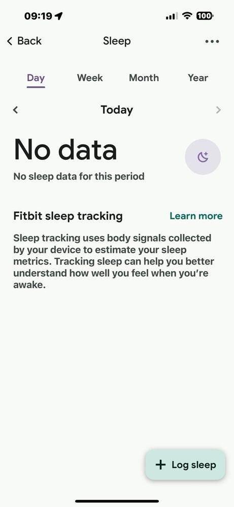

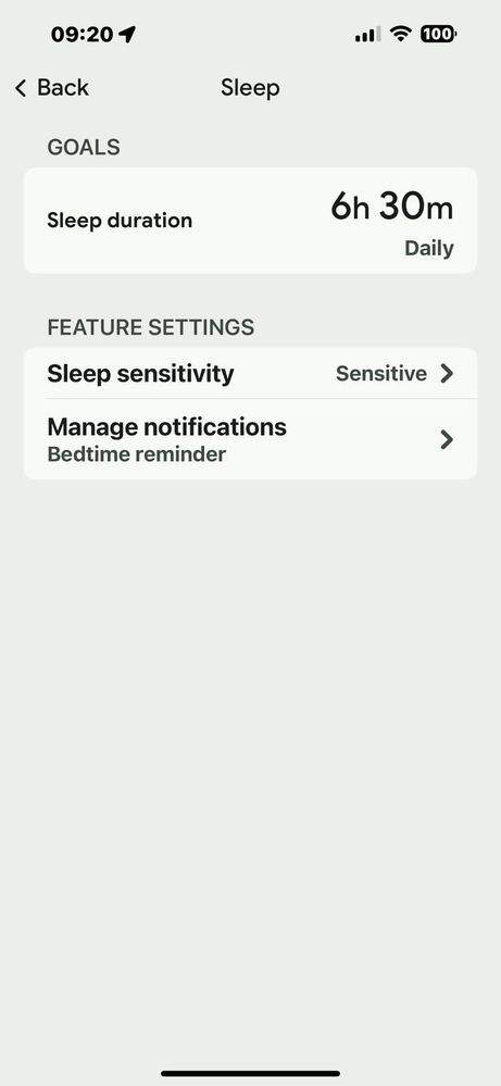

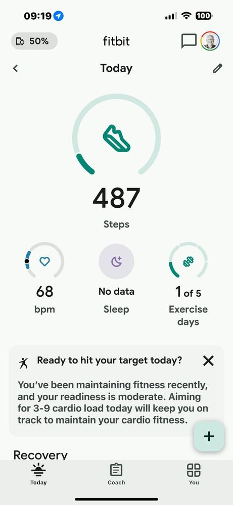

Recently, (Week or more ago) My Fitbit app stopped showing my Sleep score completely

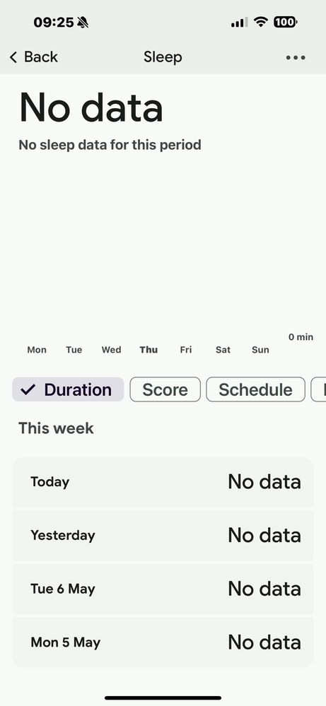

Strangely when i looked back on historic sleep records as soon as i accessed the page all the data removed itself ? Was there initially and then each past week I opened it showed data for a couple seconds then just Disappeared ?

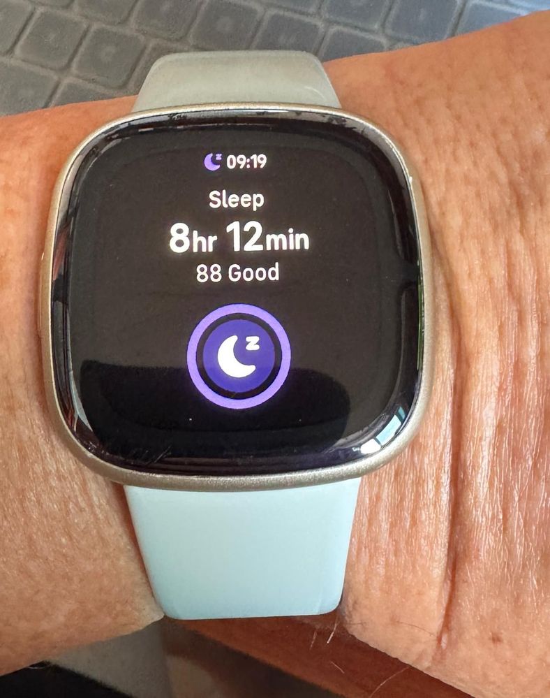

My sleep score shows on the sense, just zero in the app, it will not even let me enter a Manual Sleep Record ?
I have tried everything, unpair/Pair, remove from account add back, fully reset watch to Factory, deleted app and added back all these multiple times, am at a loss what to do now as really wanted the sleep in the app
Anyone have the same thing and have a fix please ?
