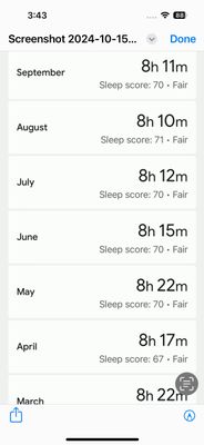

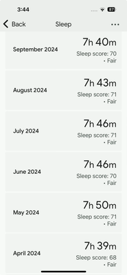

07-07-2025 19:07
07-07-2025 19:07
Above are two screenshots of my 2024 monthly sleep time, from March of 2024, through September, 2024. The bottom screenshot I sent to a friend in October of 2024 (that's why I still have it). Above that is a screenshot from just now, taken today, of the exact same time period. You can clearly see the numbers have all changed significantly from later last year until now, currently. And it all changed just about 2 weeks ago along with my sleep times, daily, since then.
