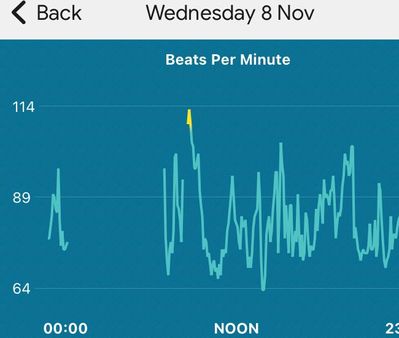

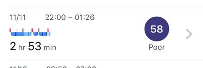

@Lisar41 Hi. There’s been quite a few posts with similar feedback across the Sense 2 pages so I’m leaning toward believing it’s not singular device related.
I’ve also had exactly the same issue you have described. Attached 2 of my screenshots from November 8th below. Whenever I got the shortened sleep data it coincided with a long break in heart data BPM overnight for the same time period. It’s a random occurring issue for me. At the moment it’s back to working 100% fine and I’ve done nothing different. I’ve only ever had the issue occur since installing the new App v4.0 onwards. I’m on v4.04 of the App now. Interestingly even though there appears to be a break in heart rate BPM overnight on the App screen on occasion I did look at the heart rate tile on my sense 2 device overnight to check if it’s recording and that has never shown any breaks in data.

Hi, I've checked the HR data for the same period and it shows my HR was tracking at my usual sleeping HR of around 43 to 35 BPM, but the fitbit literally stops at 1.26am on this occasion but I have loads of other ones which show it stops at 3am often, and I'm definitely asleep.
