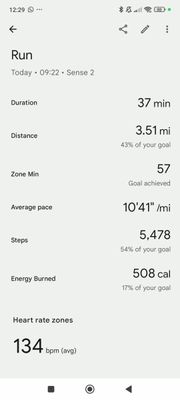

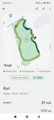

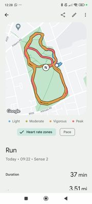

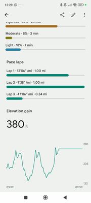

I had the same issue today. The Fitbit app shows a distance of 3.5 miles but when existed to Strava it shown 2.34 miles. On the activity map in Fitbit the GPS map in the Heart Rate Zone shows the full distance. The Pace map and data cuts off the after 2.34 miles! How can the Fitbit data be different from the same activity, on the same watch in the same App! See screenshots below.
