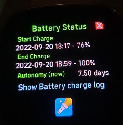

Where are you able to see the battery stats like that?
Best Answer09-25-2022 23:29
09-25-2022 23:29
On my watch face SimpleClockPro on a Sense that the user has for this topic. It's not available yet for the Sense 2.

@Guy_ I am curious what is your usage pattern of the watch to get such a long battery life? Do you use GPS? I'm wondering, 4 days is max for me with everything off (no SpO2, snore detection, not even thirdparty apps installed, default watch face) but tracking runs with the GPS (that I cannot give up).(talking about original Sense).
Best Answer09-25-2022 23:55
09-25-2022 23:55
@t.parker - same as you but without GPS, instead a lot of vibrations for things. What you get is good for your usage.
Of course results can be scewed, as battery depleats quicker at the beginning and end of battery life, and at different times in 24 hours - uses less overnight. Can depend a bit on watch age too.
