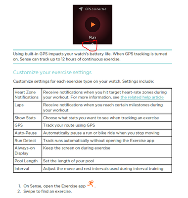

From Firbit Sense Manual (pdf)
Sorry, tough to see arrow at bottom here (I circled); windows snipping tool image gets compressed.

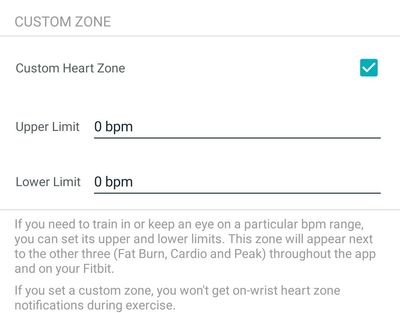

@M66E if you want notifications for custom low/high HR then it isn't possible. You may do what @JohnnyRow suggests and use HR zones notifications but there is no way to set up custom notifications triggerd by any HR. Fitbit has no such feature.
You may set custom zone but I don't know whether you will get any notifications. The description suggests no notification for standard zones but it's unclear whether you will get any notification for custom zone (I never tried it):
It isn't a sports watch but simple activity tracker. It doesn't come packed with features. I have seen the feature you are after in other brands, though.
