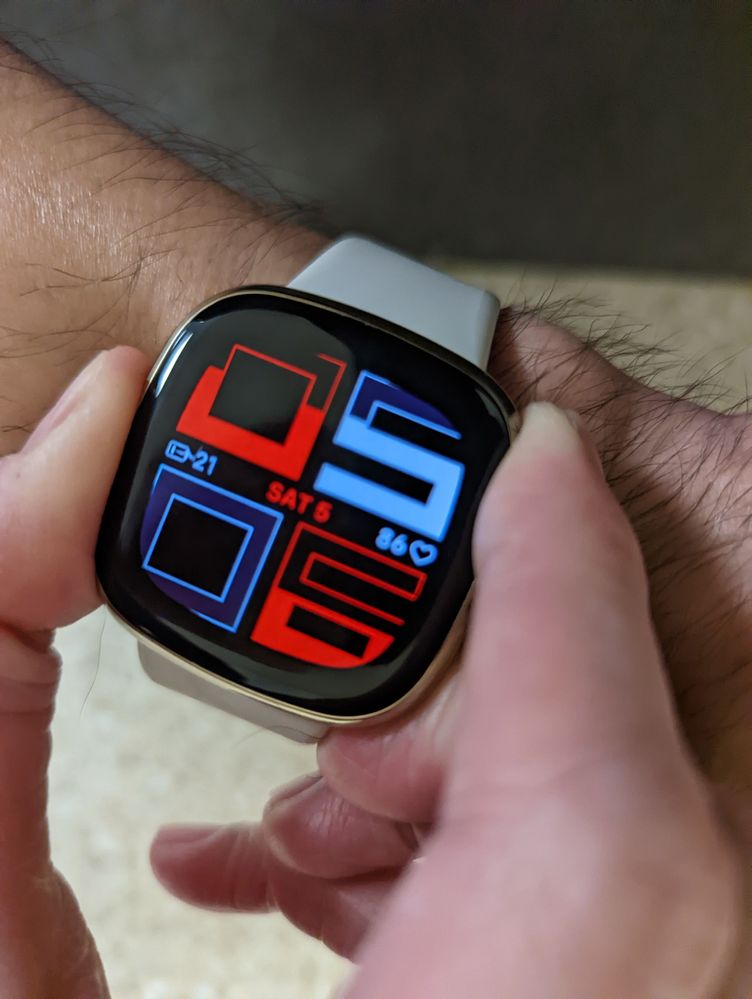

@Jetskijo what's happening is the press is getting canceled due to moving finger (or changing pressure etc.). When you try to reboot the device you need to a) be very still b) apply fixed pressure on the button. It is a chore. Rebooting the device can be very frustrating experience.

What @t.parker was talking about is you might be pressing the button in a way that's canceling the long press. It's very simple for me. I have the watch on my left wrist. So I use my thumb to press (squeeze like I described before) and my pointer/index finger is on the opposite side.
@eezeepee I do it the same way, there isn't much room for doing it any other way but rebooting for me always was a chore. Best not to even breath holding that cursed button 😋
@t.parker haha. I just know if I get my Google Assistant, just keep holding and I'm good. I don't do it too often really. I prefer a "proper" shutdown and power up. I save the long-press for a freeze up.
For God's sake......after the umpteenth time of pressing that button (and it was a good 20 seconds, same as many times before) it finally worked. This is my LAST fitbit!!
