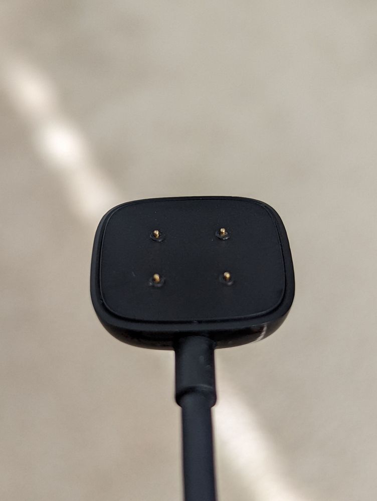

This is how the charger pins are supposed to look. If any of them are missing, stuck in, or in anyway doesn't look like this, you should contact customer support.

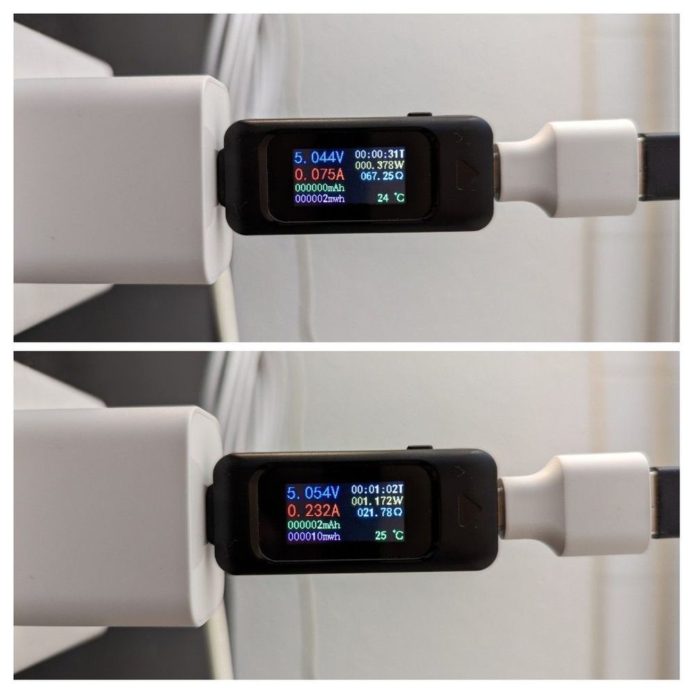

I have a USB meter to see the charge numbers on my devices. The top pic is a poor connection with only 0.075A and 0.378W. The bottom pic I did a quick wipe and connected it again (you can tell by the only 30 seconds difference) and the improvements were immediate with 0.232A and 1.172W. At that rate, it's fast charging and I can get about 2.2% battery per minute.
