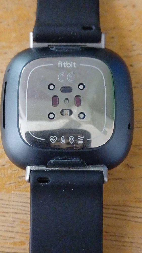

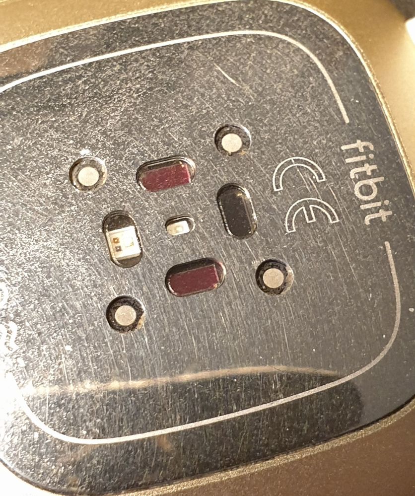

If by "the devices" you mean the chargers, then all I have done is to inspect the outside of them. There appears to be no damage to them. However, I attempted to connect them to the Sense using my computer USB as a charging port. I also held the button on the Sense down for 10 seconds to try and force a restart. The computer gave me a message that said, "The USB device you attached has malfunctioned." The Sense had some white lines flash across the face, and then showed the 0% message again. After that there was no response.
The back of the watch also shows no damage. The contacts on the watch have what (at first look) appear to be black marks on them. However, upon inspection under a bright lamp those marks appear to be nothing more than normal wear; i.e. no scorching or damage. As I said to Odyssey 13, I have another Fitbit brand charger coming from Amazon today, and don't want to try these ONN ones again.

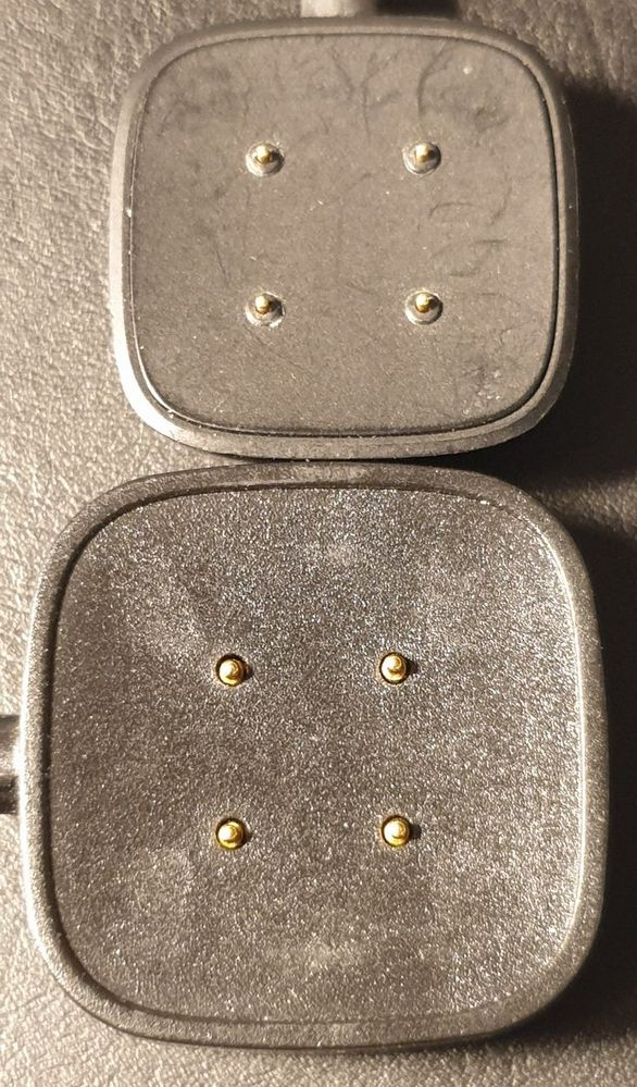

Here are some photos to compare.
Top charger is the Fitbit one
Next charger is one direct from China, works better
Last photo is my Sense which needs cleaning as contacts aren't as gold as they should be.
Fitbit cable on top

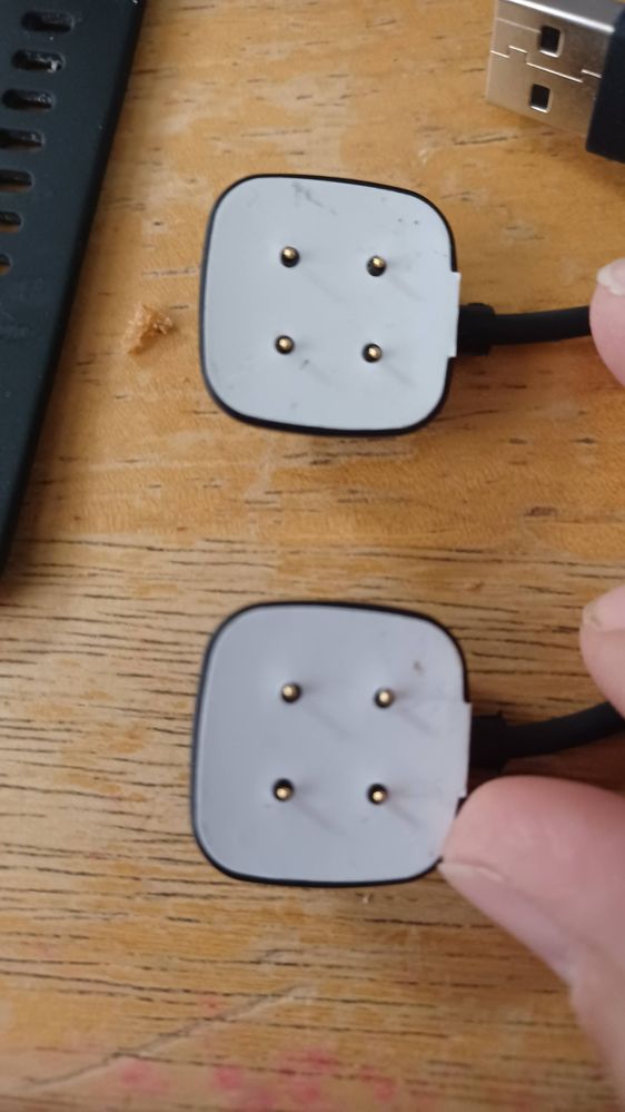

Well, let me try and upload some photos of my devices.
As you can see, the contacts on the back of the watch are not gold colored. I don't think they were when I got the watch.

@SunsetRunner - thanks for the good photos, it all looks good and no visible damage. Are you sure it isn't actually just a watch problem?
One thing to check on the charge cable is that the pins are all the same height and have the same spring pressure.
What may be possible is the pin centers don't correspond with the holes and if the magnet is incorrectly placed the pins could be touching the metal case.
The only way to know is to use a meter to see how much current is being drawn. The one I use measures a maximum of 310 ma
Am not an expert but imagine the contacts are merely a means of applying power from the USB power source to the watch and that the cable has no circuitry inside. So it either makes good contact, poor contact or none at all. May be someone else knows.

I don't think it is a watch problem, per se. It was working fine until I used that charger. I DO think you might be onto something with the spring/pin strength/positions. The springs under the pins on these chargers feel very loose and sloppy. Also, the pins don't appear to be the same diameter as the branded ones when comparing the photos above. Purely subjective I know, but 🤷🏼:male_sign:,
