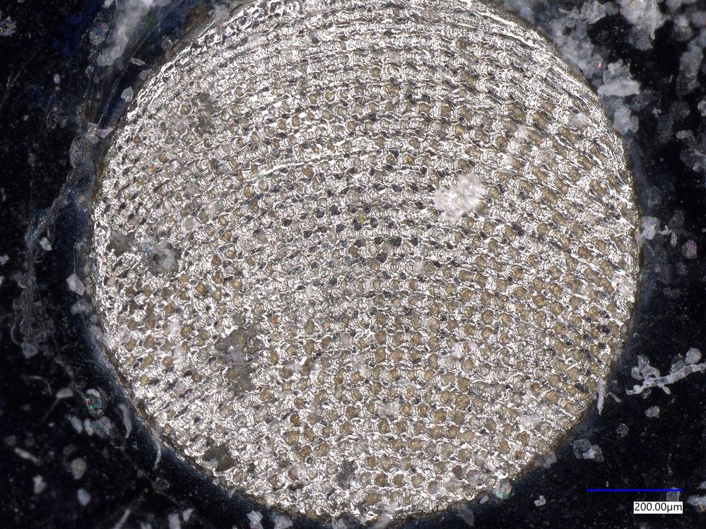

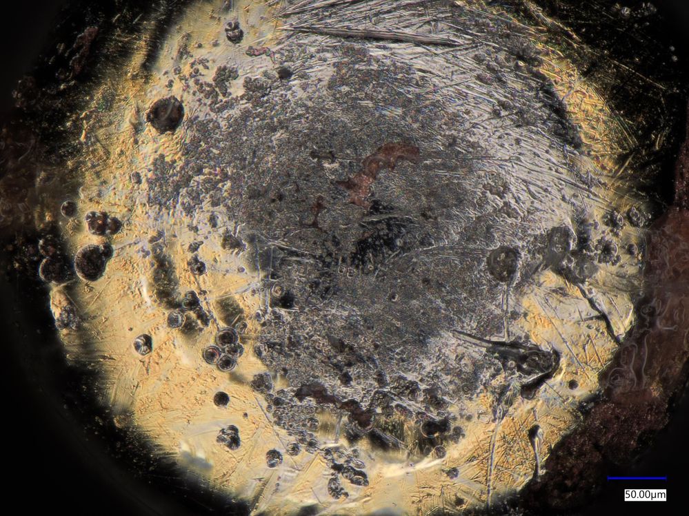

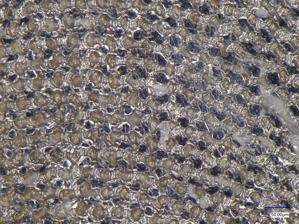

I took several photos of the contacts using a Keyence VHX laboratory microscope. The image shows substantial wear and pitting of the charger pins, however, the Sense contacts look like they have minimal wear. Looks like the charger pins are sacrificial instead of the Sense. Maybe too sacrificial.
8 month old charger pin.
Charging contact on Sense
500 x magnification of Sense charging contact
