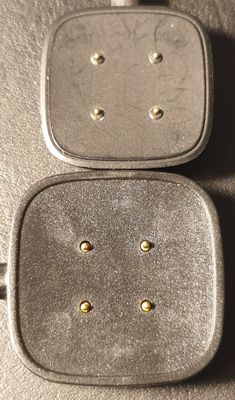

At 5.25 volts about 320 milliamps. I measured 100 milliamps when using a "PD" type charger so I think that it cannot communicate with the PD chargers. The older chargers some have an IC that attempts to determine if a Samsung, LG or IPhone is connected otherwise a resistive voltage divider is connected across the Data+ and Data- pins which tells the device under charge that the charger is a dedicated charge port capable of a certain current. Another issue with charging is the ground pin on the Sense charger seems to have a weak spring in it. A third issue is the plating on the charging pins seems to be either inadequate or intentionally sacrificial vs. wearing out the contacts on the watch. See my microphotographs.

@KB9WNS - thanks for the photos - impressive and interesting.
What should be noted is that the watch contacts [indentations] are less exposed to the elements however a layer of grime can accumulate which may offer some further protection, if not corrosive.
Whereas the charge cable contacts come into contact with all sorts of things from finger oil to metal objects [because they are magnetic] and are permanently exposed to the air and elements and more easily damaged.
Any grime causing sparking will damage the weakest element most, hence the need for good cleaning.

My charge cable from China [$3] seems to be more solid and better built with larger pins and better travel than the Fitbit one.
Fitbit cable on top
