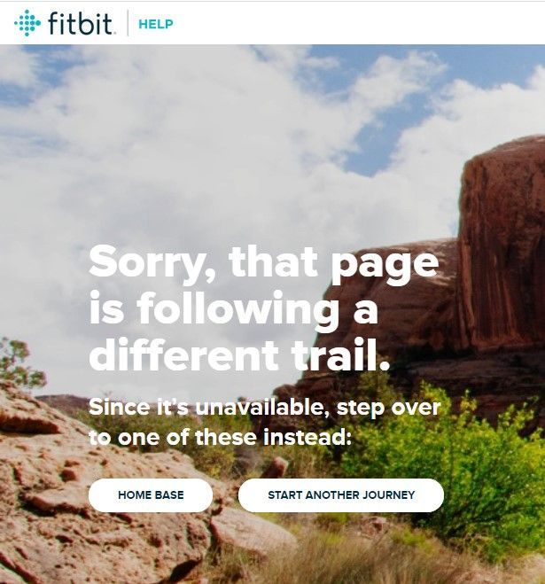

Greetings all,
So I tried getting in touch with Fitbit support via chat. Appears that support by chat isn't working, as it leads to this page...
Ugh!
thanks,
ben
