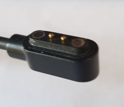

Apparently this is a common problem. The charger cable has an apparent
design defect as one of the pins will get stuck and will not make contact
and therefore the sense will not charge. Contact Fitbit. They will send
you a replacement cable.

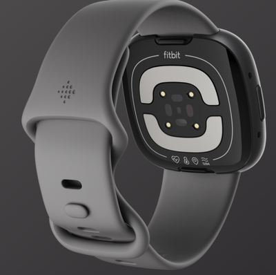

Supporting @CraigHansen's (and others') hypothesis that this pin carries significantly greater current is the fact that the charging port on the watch corresponding to the miscreant pin is blackened, at least in my Sense. This indicates overheating. The other three ports remain shiny. When I mentioned this to the Fitbit rep, they indicated I should clean that port with rubbing alcohol and toothpick. I used that and a toothbrush. The colour did appear to lighten negligibly. Sadly the discolouration remains baked in.

@JerryHuiskamp  - lion batteries require a very specific current based on their charge level.
The watch won't or shouldn't ever draw more than around 300 ma when nearly empty to about 10ma when nearly full.
Sparking due to bad connection or dirty contacts is more likely the issue, especially if one pin is too short which will make it worse as the heat increases due to more sparking with each successive charge.
Hi, @C4Me Your best way forward is to review the many posts here on the charging problem. Look at the 4 little pins on your charging cable (replacements can be bought from Amazon at a modest cost) clean the back of your "Sense" with rubbing alcohol you may need to charge for up to 60 minutes before you see signs of life. There are lots of tips here, loss of battery charge is the most likely cause of your problem excluding warranty issues which no longer protect you as it's more than a year old. Do bear in mind in some jurisdictions warranties are longer than a year as required by local legislation. I recently saw the suggestion that if you bought your "Sense" with your Credit Card under some circumstances some Card providers give an additional guarantee, I've no experience of this but it might be worth checking.

Good find by primordal. Now I know why my Sense stopped charging. Sure enough, one charging pin is essentially fully recessed into the charger base/charging pin “silo”.
First the good news: my replacement charger was delivered within 24 hours after I reported the problem 👍
Now the bad: after 5 days, the new charger did not work 👎. For the first three days on the charger, nothing happened. Then magically, it charged to 21% and stayed there for a day. One more day, progress - reached 100%. I wore it for the day, put it on the charger overnight - nothing - down to 0%. All throughout, I tried many things to get the charger to work. I think the recessed pin is no longer the problem. Likely, the corresponding charger port is.
