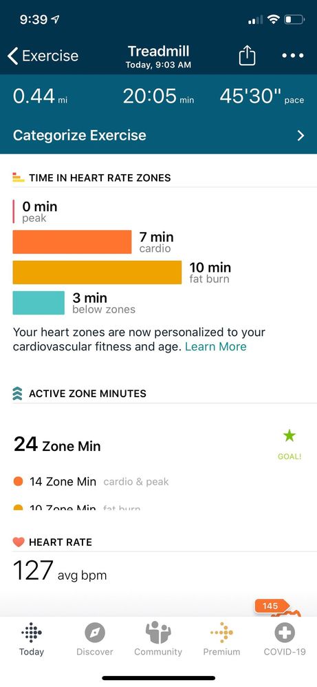

I have figured out the problem but do not know how to fix it. I did exactly 1 mile on the treadmill and ran the treadmill exercise app on fit bit the entire time. The app only shows I walked .44 miles. How would I fix this? It is accurate for normal walking7DFE1D06-D6B7-4D0E-8D51-43E0373865F9.jpeg
