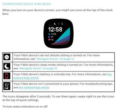

Also, my watch keeps showing a phone w a slash through it-I am guessing that means a connection error w my phone.

From Sense Manual :

Thanks again. Checked that, status indicator is on.
