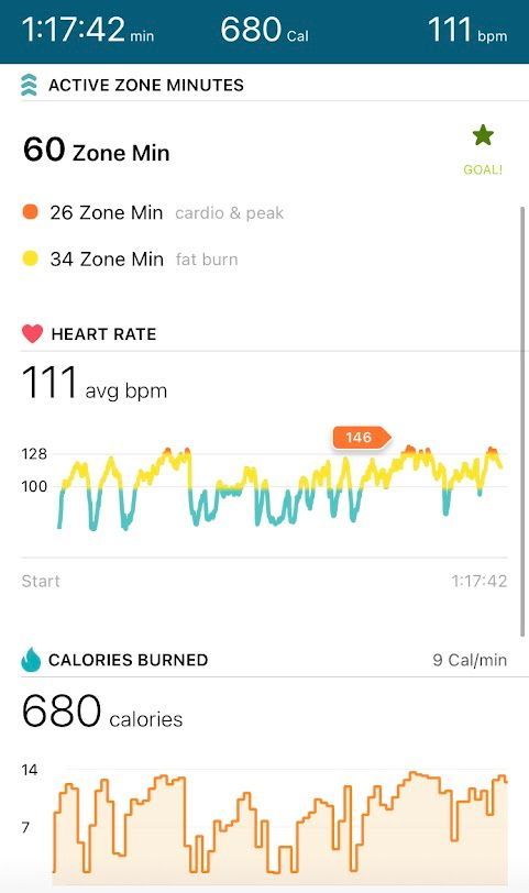

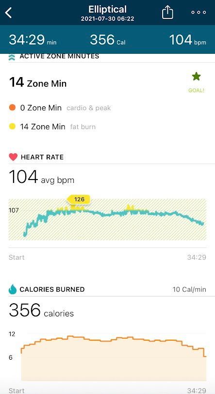

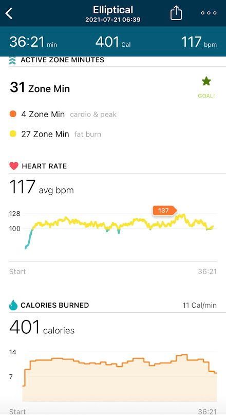

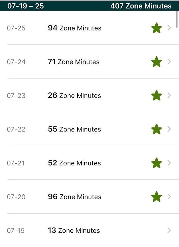

Sadly changes has no effect.
Did reset my sense, updated to latest firmware, changed Heart Rate settings to custom numbers and restarted and synced several times. No SPO2 face app as suggested.
Zone minutes chart numbers dropped drastically
In comparison active minutes one week with Ionic and with Sense, activity and number of workouts are very similar
Toughest workout of the week - legs, 7 day apart on the same time. Coincidence that even workout duration is the same
Elliptical cardio workout numbers are better but still not satisfactory, Sense delays increased HR up to 10 minutes. Resistance levels are identical and workouts occurred on the same time less than a week apart
So Sense goes on the shelf again and I am losing hope that Fitbit will fix this critical functionality 😞
